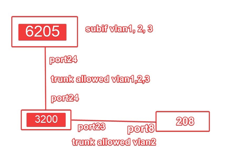

Dear supporter,
I have following device: RG-NBR6205, RG-NBS3200, RG-208GC.
I've aleady created sub interface with VLAN on NBR6205 Vlan1-3,
NBS3200 port 24 as Trunk port allow, Vlan1-3.
I also configured NBS3200 port No.23 as trunk port allow Vlan2 and connected directly to RG-208 port No.8.
RG-208 port No.8 also configured trunk Vlan2. But it seems that it did not work.
Can you help me ?
Thankyou!
RG-NBS3200-24GT4XS
Switch
0 2025-6-5 07:31:45 View all replies
Hi Tinh,
In my understanding, your topology looks like this:
Could you please give me the "show run" configuration on all the switches? We will then see what you are configuring on each port.
