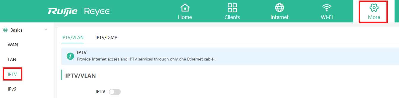

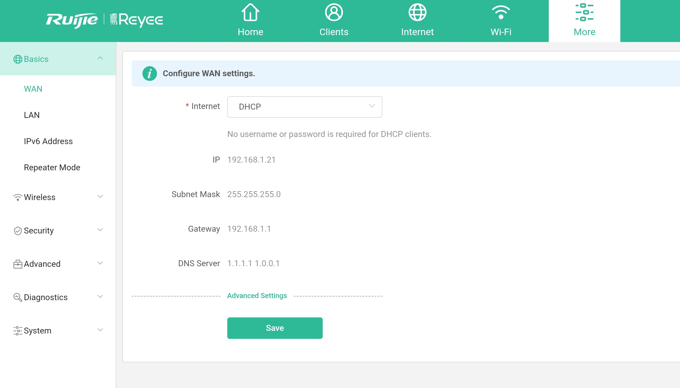

I am trying to configure EW1800GX-PRO for PPPoE, IPTV.
The user manual instructs to go to IPTV settings to enable it. However, I do not have that setting tab enabled.
I think there is a software problem. Maybe an update is required.
(Screenshot is not from PPPoE but it is exactly the same.)

Hello,
Thanks for your inquiry. Can you confirm that the device has the latest version installed ?
I just confirmed with a device EW1800GX-PRO, with the ReyeeOS313 version and the feature is there.
If not, can you upgrade it and tell us if the issue persists?

Hi,
I had something like 1.77 from the box. (Unfortunately I don't have a screenshot.) just downloaded the 1.313 version and everything is working fine. Of course out of the box, it did not had IPTV, I had to change the firmware version.
