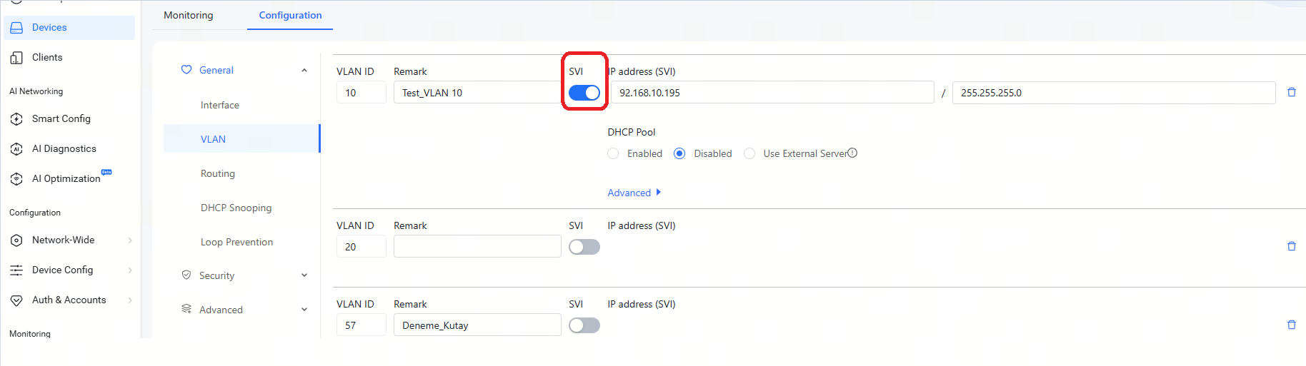

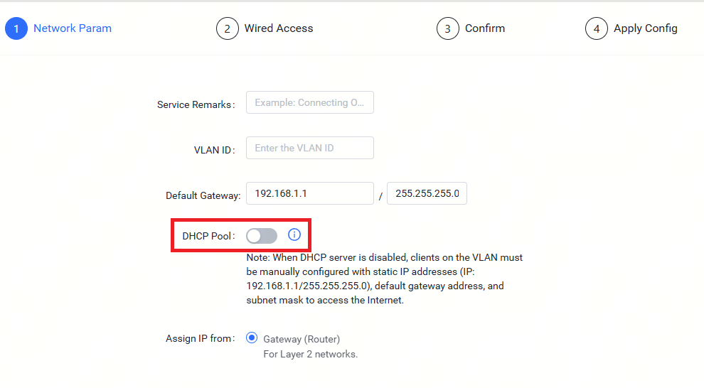

When creating a VLAN, you can disabled the DHCP pool for the VLAN. You can refer to the guide below regarding more details.
https://cloud.ruijienetworks.com/help/#/ArticleList?id=e945f0446ace466b86542e2610c1c96f
You can also disable the DHPC pool on an existing SVI in the device config page. The alarm in your project will be cleared about 9 minutes later after the issue is resolved

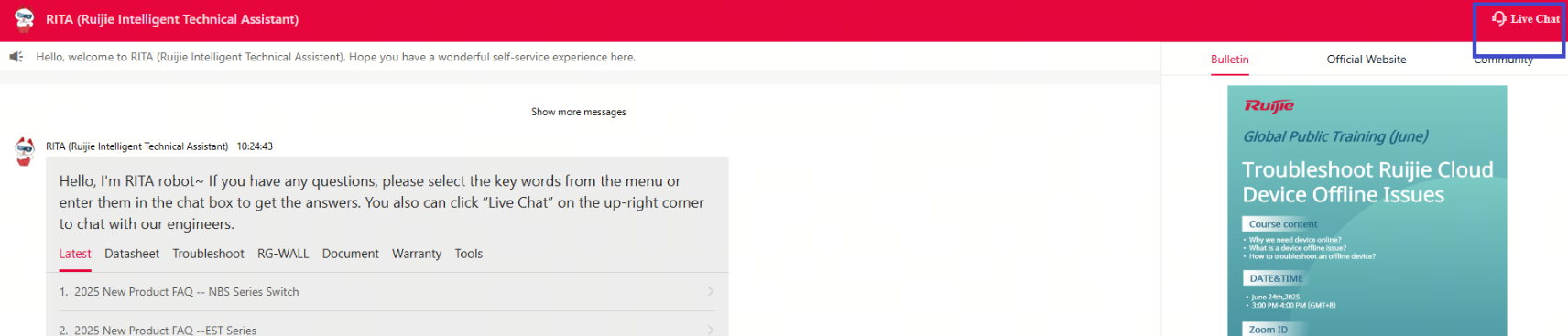

We will need to check the network via project sharing. Therefore, to share the the project in a secured channel, we  encourage you to contact us on Rita(www.ruijienetworks.com/rita), our real-time support platform. Our dedicated engineers are readily available to resolve your issues promptly.
You can click "Live Chat" on the top right corner of the page to contact our engineer.
