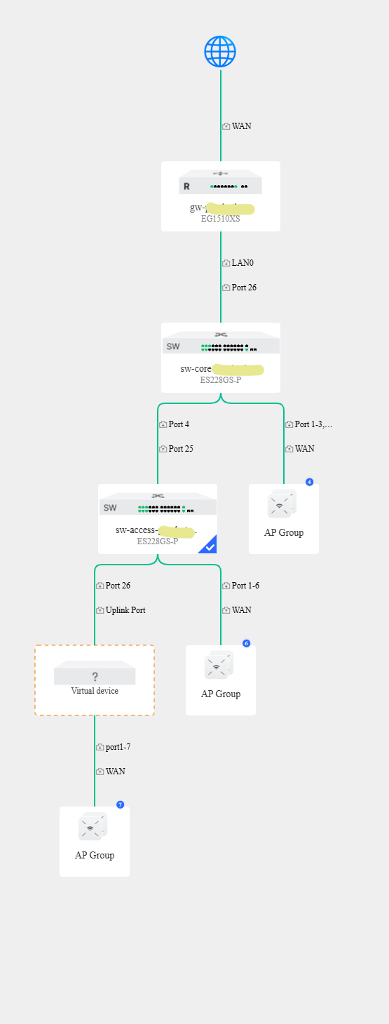

Dear All
I have 3 managed switch Model:ES228GS-P on my network.
But one of my switches is detected as a virtual device
RG-ES226GC-P

Hi GTAC-Ryan
Thanks for the answer.
Now my problem is solved. I just need to re-enable VLAN ID 1 on the trunk port, and the virtual device can be detected as a switch device.
