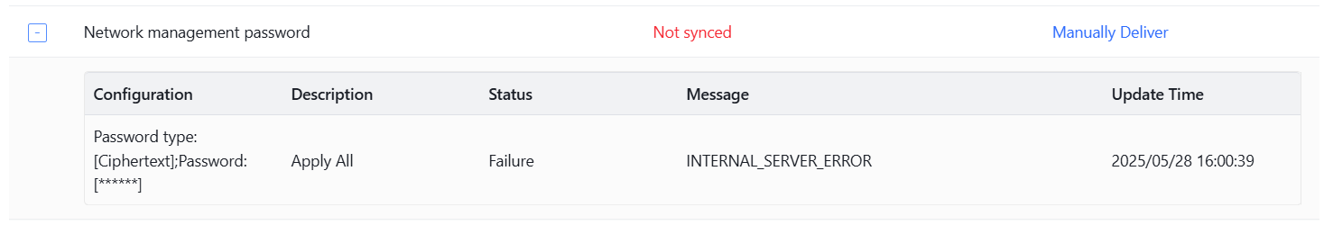

Network management password not synced - failed
Unable to resolve
See attached images

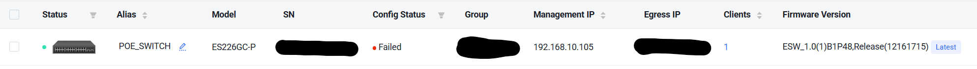

RG-ES226GC-P

Hello sir,
Have you tried manual synchronization? Or have you tried restarting the device?
Or is it that the device cloud shows that the synchronization is not successful, but the local device has been successful? Can you now log in to the local device with this password?
0 2025-5-29 07:10:54 View all replies
GATC-Emily replied at 2025-5-28 15:59
Hello sir,
  • I have tried manual synchronization.
  • I have restarted and changed password
  • It's the config status that shows failed
0 2025-5-29 07:14:26 View all replies
Changing to an easier password has now resolved the issues.
