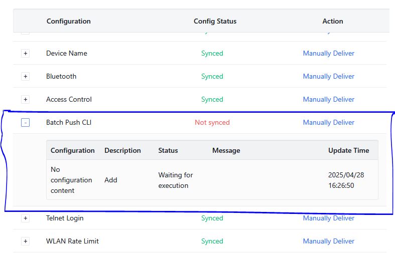

It's trying to sync a non existing configuration. How to get rid of this?
I tried manually deliver and restarted the device. not working

Have you tried to manually send the configuration? Or you can try restarting the device or logging into the device WEB interface to check whether the configuration is synchronized.
<img alt="image.png">
0 2025-7-3 11:07:12 View all replies
Solution:
create a dummy config task
