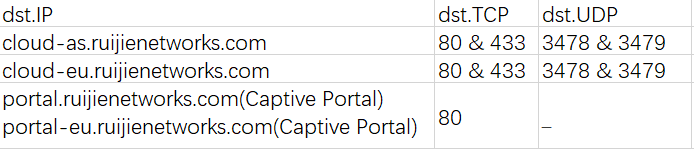

     3)  Following ports are used for Ruijie Cloud management. Ensure these ports are available and the data stream is permitted.
Ruijie Cloud Server IP and Port-public

Dear,
Could you  share the model  of the AP?
Please  check if the UDP and TCP ports are enabled on the  ISP  or  gateway switch.

Hi,
My AP's Model is RAP2260(G)
Could you please share me a UDP & UTP port in conclusion for allow ap to join cloud dashboard.
0 2024-5-14 12:55:53 View all replies
Surapat Thanapak replied at 2024-5-14 12:49
Hi,
Could you please share me a UDP & UTP port in conclusion for all ...
Hello,
Do you want to ask which ports need to be released?
I have shared the port that cloud-as.ruijienetworks.com needs to be released according to your location, please check the following table. If you have other questions please keep talking to me and I will be happy to help you on the community
