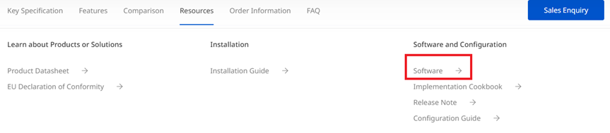

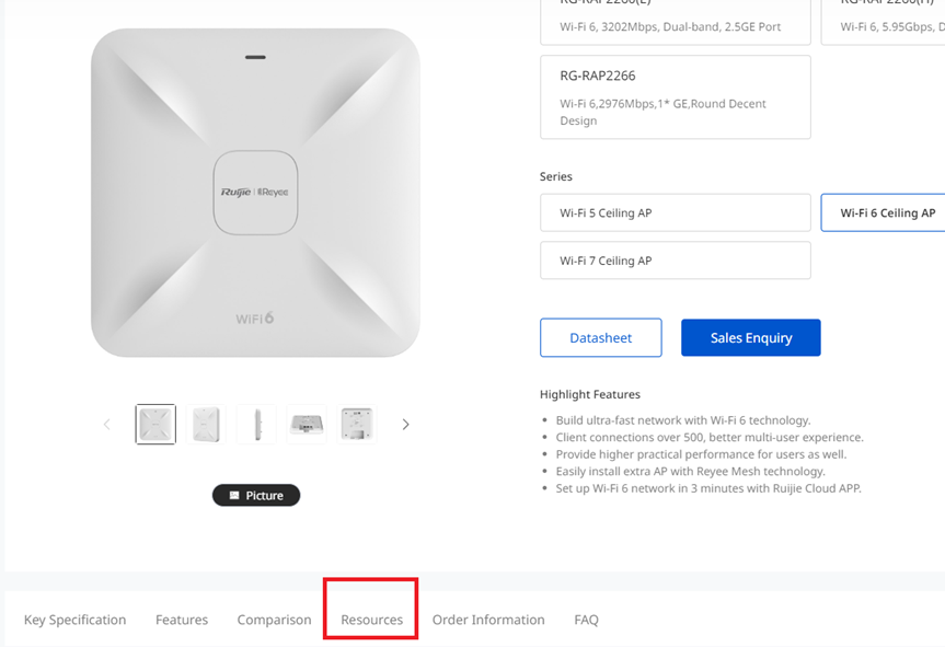

1. Dowload the version of the firmware that needs to be uploaded from the product page.

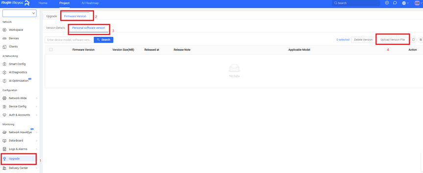

2. Go to Upgrade page of the project and click "Firmware Version -> Personal Software Version -> Upload Version File" to upload firmware.

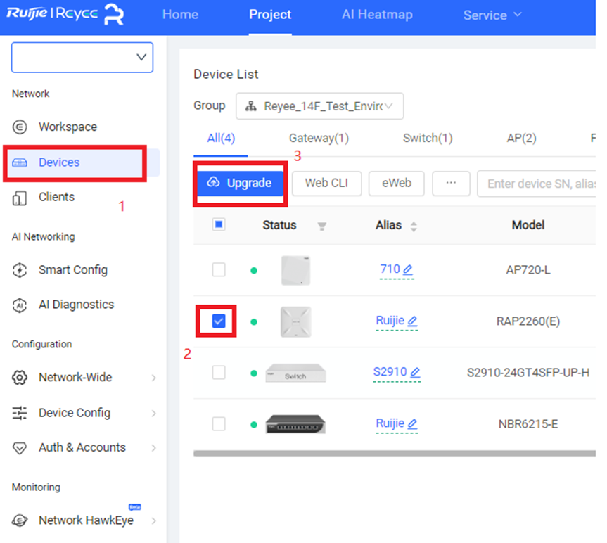

3. After the file is uploaded, go to the device list of the project and select thedevice that needs upgrading.

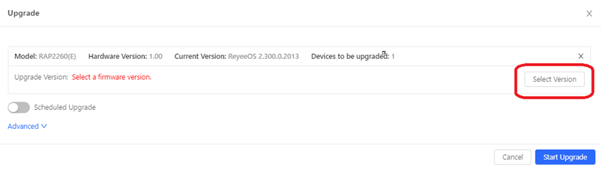

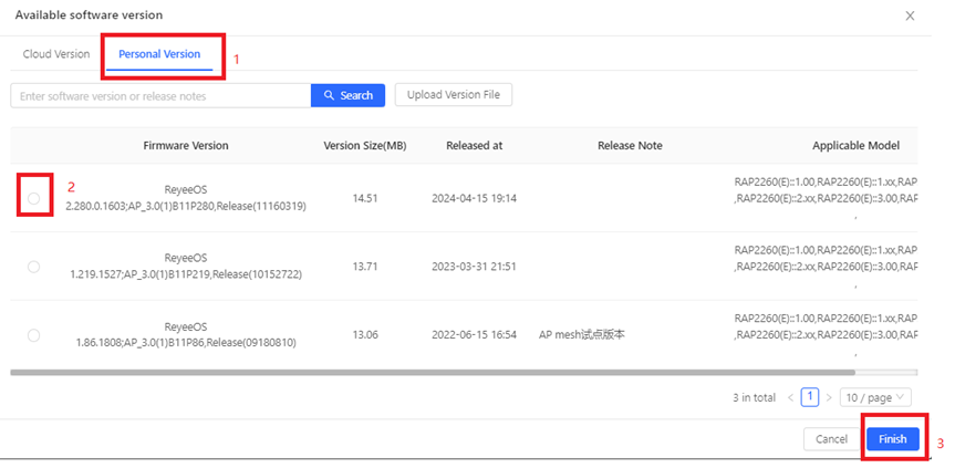

4. Select the uploaded version to upgrade the device.
